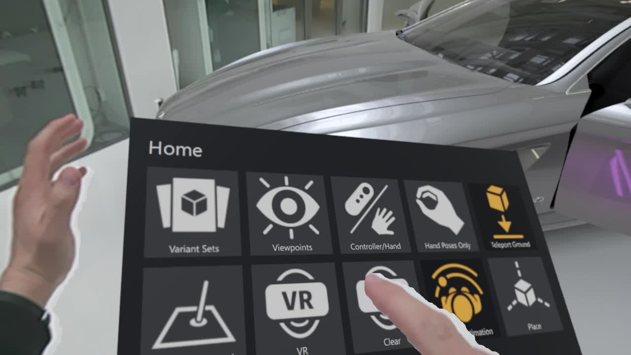

MR Hand Tracking
When in MR with Hand Depth Estimation disabled, you can now enable tracked hands to be displayed over your real hands to help with VR Menu selection. To set this as the default behavior in MR, go to Preferences > Extended Reality > Interaction > Hand Tracking, and enable Show Tracked Hands in MR.
Image of tracked hands over real hands in MR

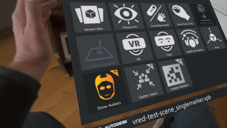

Varjo Marker Tracking
We added Varjo marker tracking support in OpenXR to better support Varjo headsets.
