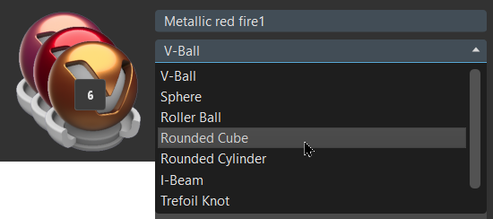

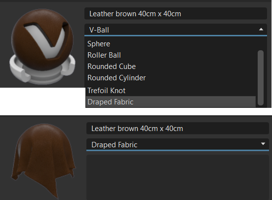

Change the shape of the material thumbnail to best display the material, using the material preview dropdown.
To change the geometry, click the dropdown next to the current material preview and select another option.

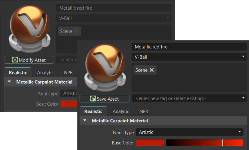

However, if the material is an asset, you will need to click the Modify Asset button, first. Then, if you want the change to affect all references of that material, click the Save Asset button.
You can assign a different material preview shape to multiple materials (as long as they are not assets) at once by multi-selecting materials in the Group Preview, then selecting a shape from the material preview dropdown.
