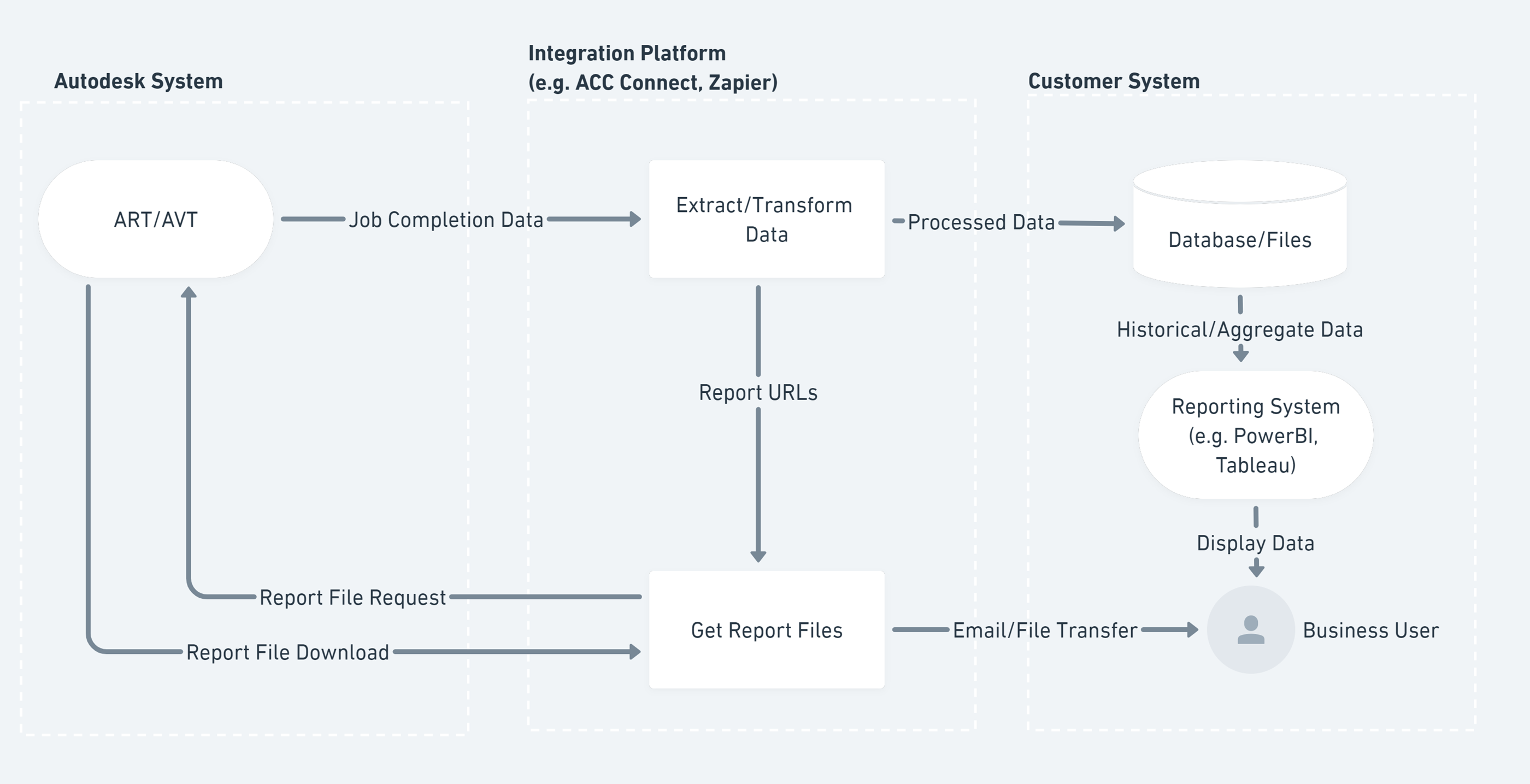

Overview
Webhooks allow for automated processing of results from the Autodesk Validation Tool (AVT) and the Autodesk Replication Tool (ART). Upon completion of a task, a set of data is sent by the application to a configurable server URL. This can be a web server run by the client, or a third-party service designed to process such data. Examples of third-party tools include:
Below is an overview diagram summarizing typical use of webhooks.
webhooks workflow diagram

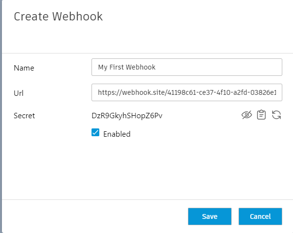

Fill in the following fields to create the webhook:
  • Name: A descriptive name to identify the webhook
  • URL: The destination URL which will be called by the webhook
  • Secret: The Secret field can be revealed, copied or regenerated using the three icons on the right-hand side. See the Validation section for more information about how this property is used.
  • Enabled: Leave the Enabled checkbox selected unless the webhook should not be immediately activated.

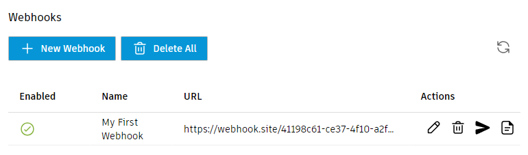

Once the webhook has been created, it will appear on the settings page:
ART ui

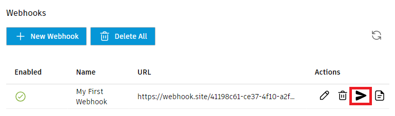

Test a webhook

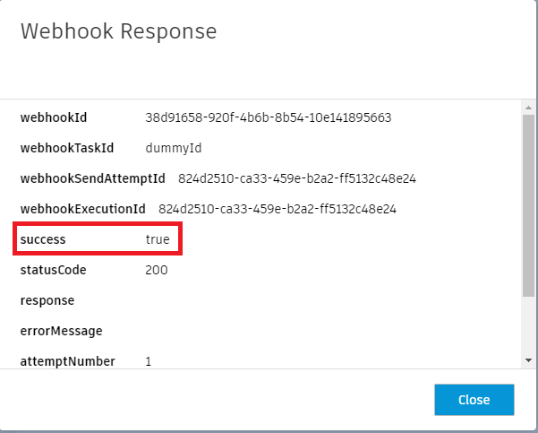

To test that a webhook has been properly configured, click the Test button in the Actions section.
ART ui
If the webhook is successfully sent, the success property in the response will be true. The destination server should also have a record of the webhook being received.

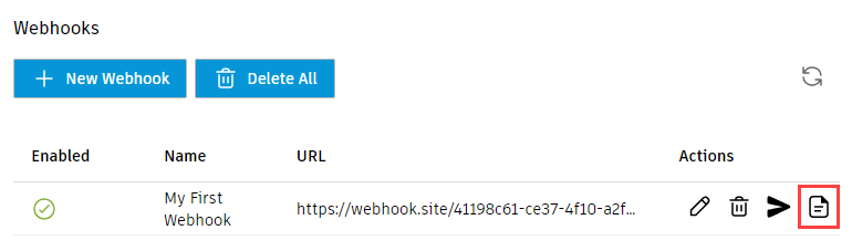

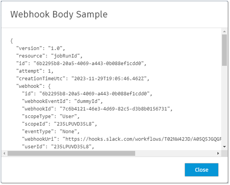

Get a Sample Webhook Body
To get a preview of what the webhook body will contain, click the Preview button.
ART ui
ART ui
