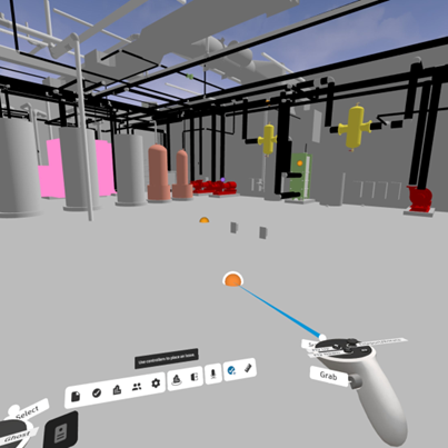

  1. The button will turn blue to show this feature is active.
  2. Use your right controller with a yellow circle at the end to point at your issue.
  3. Press "select" on your controller by pushing the trigger to place your issue.

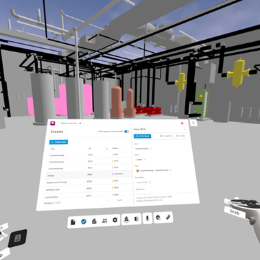

  1. Once placed, the issues console will open for you to fill in the Title, Description, and Type.
Screenshot of Issues Menu
