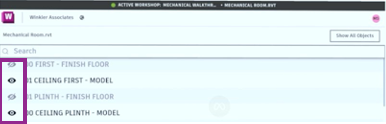

To access visibility options within Workshop XR, please do the following:
On the Core Menu, select Model.
A new window will open, showing a list of elements with an Eye symbol on the left of each.
- Click on the Eye symbol to disable or enable visibility of that element.
- The bottom of the list contains the main categories of elements, allowing you to toggle groups of elements at a time.
