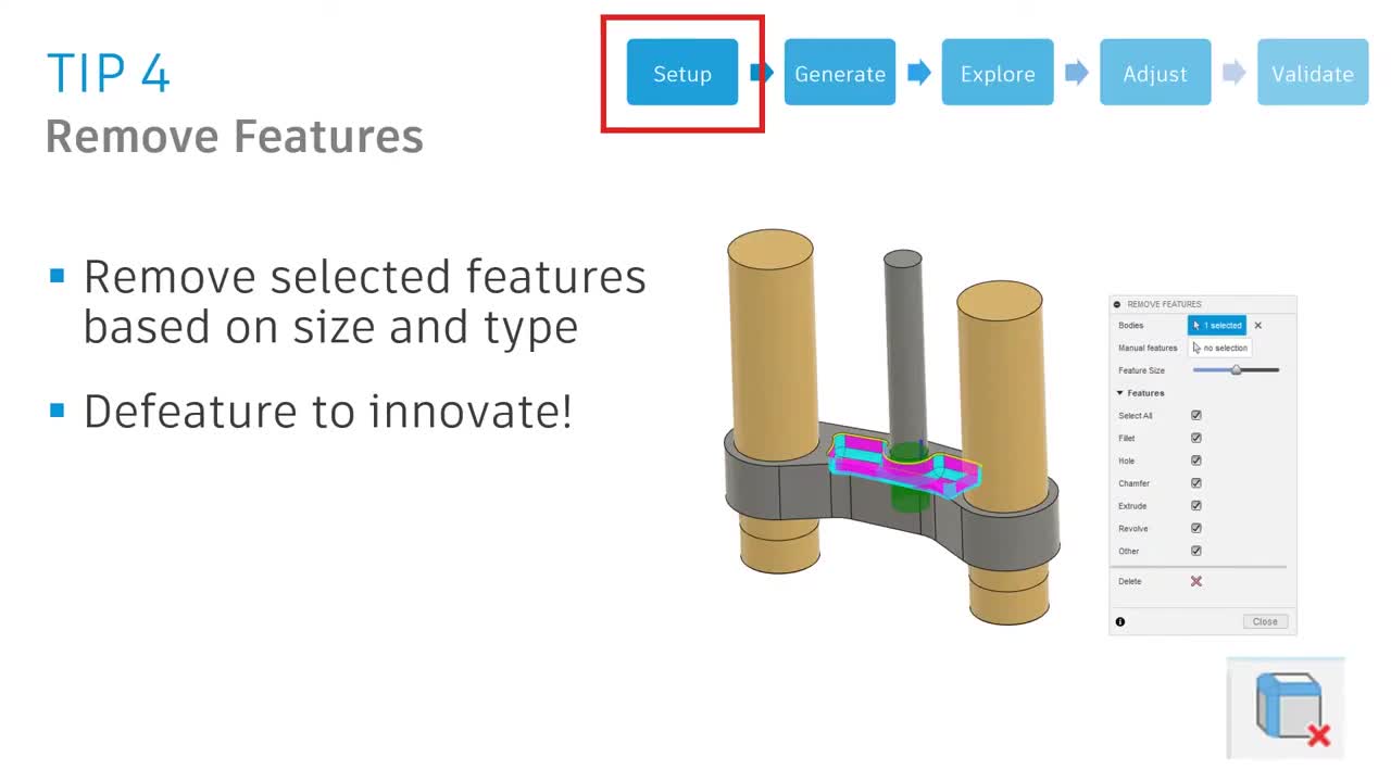

Quick tip: Remove features
Video Player is loading.
Current Time 0:00
Duration 0:00
Loaded: 0%
Progress: 0%
1x
