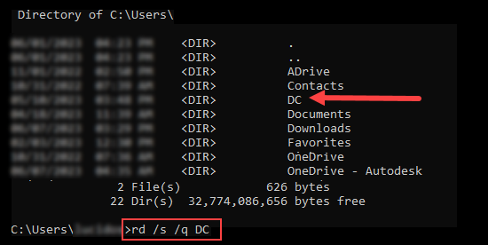

Delete the local Desktop Connector workspace. The default workspace locations are:
Note: If Windows Explorer will not let you delete the workspace then open up the command line window and navigate to the root project folder, then type: rd /s /q DC while you are in the folder preceding the workspace.
DC-Uninstall Connector
For Desktop Connector v16.x, delete:
  • C:\Users\<username>\DC
For Desktop Connector v15.x, delete:
  • C:\Users\<username>\ACCDocs
  • C:\Users\<username>\Fusion
  • C:\Users\<username>\ADrive
Important: Delete all workspaces when migrating from DC15.x to DC16.x.
