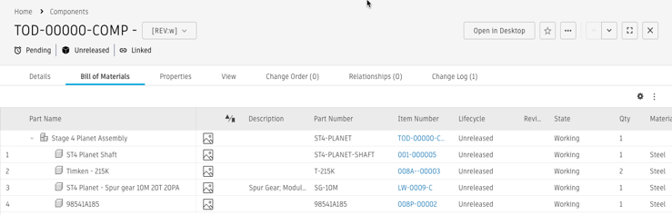

In the Fusion browser, select the item.
In the Manage toolbar, in the Process Management group, click Details
The Details page opens in a browser window in Fusion Manage.
Click the Bill of Materials tab.
This bill of materials view is similar to the Design workspace Bill of Materials. Use the Revisions drop-down menu to switch between the current working version and released versions.
