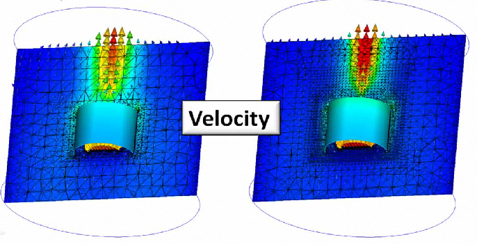

Example
A refinement region is built around a fixture. The influence on the velocity near the fixture and in the thermal plume is significant:
The influence on the temperature field is also significant:
Capturing these gradients is essential for the accuracy of the solution.
