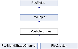

Inheritance diagram for FbxSubDeformer:Public Types | |
