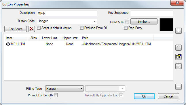

Service based hangers items can be allocated to the service with a button code. Adding across the hanger required for use and then selecting Right click Button Properties, allows entry of a button code.
Keeping th button code generic across multiple sizes allows for product listed hangers to be successfully drawn.

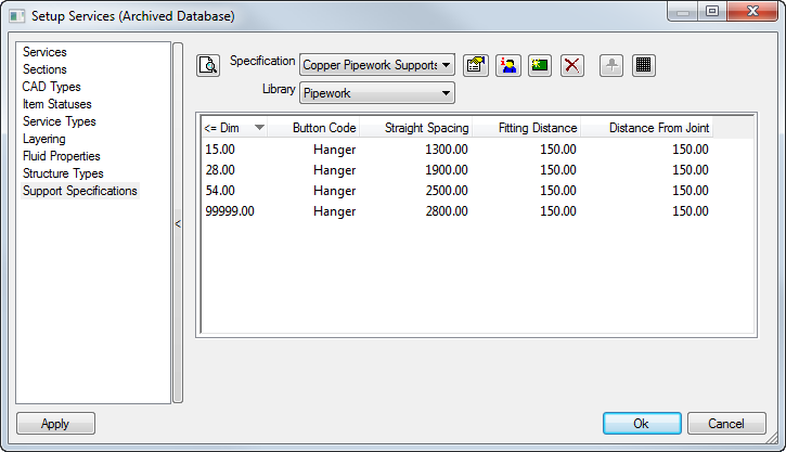

User are able to construct a service support specification which forms the rules of when the hanger is to be used and populated onto the Design Line.
Hanger nodes can be made visible on the Design line, which indicate to the user where hanger is to be positioned when filled in 3D using Design Line. Once the following help has been performed, hanger nodes will start to appear on the Design Lines being drawn by that service.
Spacing requirements (Straight Spacing), can be entered per size to determine the allocation of when a support is required along the length of the Design Line being drawn with the exception of Fitting distances and Distance from Joint options. These two additional options control where the hanger nodes are top be positioned away from joint and fitting areas.

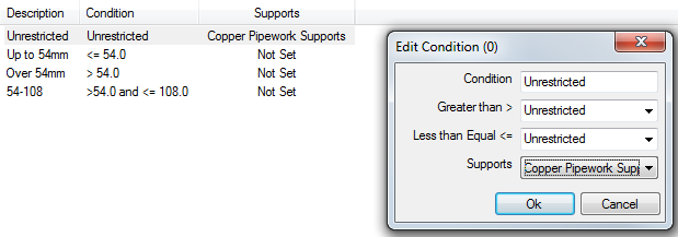

Once the specification has been configured with spacing requirements, the service template needs to know which specification is to be used for that particular range of products. Editing your service and selecting the Service Information icon allows editing of the service template and in particular the support specification assignment.
Using the Supports field of the unrestricted condition, allows the supports to become active against all sizes. Users are able to assign variant support specs to conditions if wanting to control variant styles but this can also be achieved from the specification using button codes to call for the particular hanger item at variant sizes. (For example Gripple type up to 200mm and then another hanger type of Split Rings above this size.)

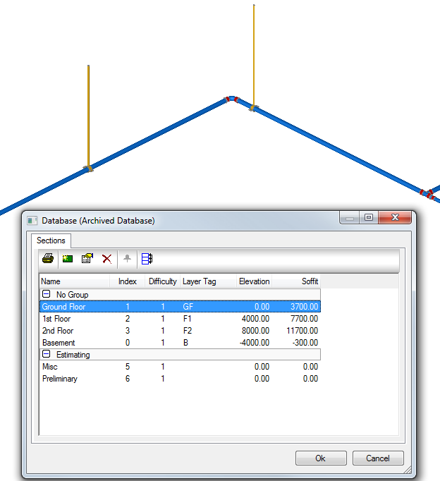

When the action to Fill in 3D is performed, the hanger will display as an individual item with the rod extension calculating itself to the sections Soffit height which is calculated from the elevation the item has been drawn at.
The example below shows spacing requirements falling on or around the 90 elbow. Due to the support specification assigned, the distance from joint and From Fitting values, cause the hanger to adjust accordingly and position the hanger after the bend.

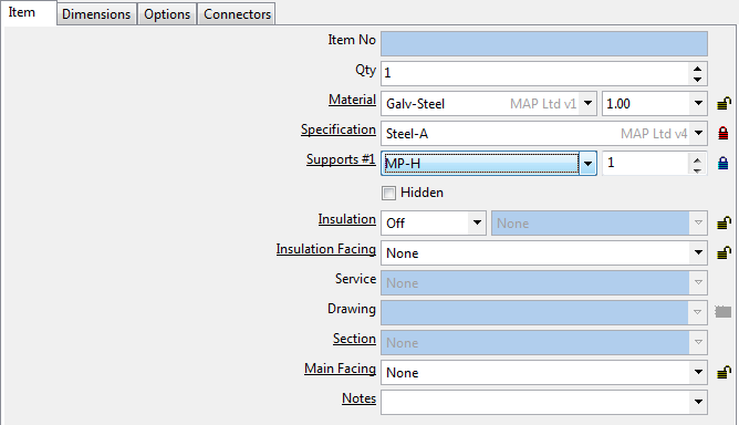

If users are looking to price and quantify the ancillaries each support is generating then the item is required to be locked against a support ancillary. The support assigned needs to contain the makings and build up of the ancillaries in question. The example below shows the service item being assigned (and locked) with a quantity of "1" for the MP-H hanger type.
Each time the support specification calls for the hanger to be filled with Design Line, the cost breakdown of the MP-H will be used x1. For more information on the makings and breakdown of supports, please visit the Supports - Example topic which details advanced costing and ancillary assignment.
The Rod height and extension will be calculated based on the Section Soffit height the hanger is belonging to. Users can specify the section along with other carry over properties when drawing each Design Line. If wanting to quantity ancillaries used then locking a support ancillary build up onto the service hanger item will allow for an advanced breakdown of ancillaries used as shown below.
