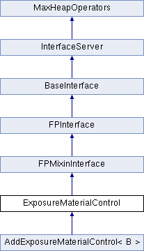

This is the inteface class to implement in order to support exposure controls.
- See Also
- Class ExposureMaterialControlImp
- Description:
- This class is an extension to allow maxscript to determine whether a material's shaded output is to be processed by a tone operator and whether the self-illumination, reflection or refraction channels are to be inverted by the tone operator so the actual rgb values will appear in the display.
This class is added to materials that want to expose control over the results of the exposure control on the shaded output of the material. This is useful when a material knows the specific RGB value to appear in the rendered image, and does not want this color to be adjusted. For example, a material might already perform its own physically-based lighting calculations with handling for image exposure. Or, in the case of specialty "non-physical" materials, it might be inappropriate to perform exposure adjustments on the color.
You determine whether a material allows this control by asking for the interface. If the interface is present, then you can set values. This is how you ask for the interface: A material can support this interface by deriving from this class and handling the GetInterface() method as follows: There are four properties in the interface, each with a get and a set method. Use the get method to get the current value and set to set a new value for the property.
The properties are:
- NoExposure
- InvertSelfIllum
- InvertReflect
- InvertRefract
Also, if you want your material's ExposureMaterialControl methods to be exposed to MAXScript, you can derive from ExposureMaterialControlImp.
