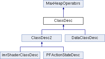

Class descriptors provide the system with information about the plug-in classes in the DLL.
The developer creates a class descriptor by deriving a class from ClassDesc2 (which derives from ClassDesc) and implementing several of its methods.
Inheritance diagram for ClassDesc:Public Member Functions | |

inlinevirtual |
pure virtual |
Controls if the plug-in shows up in lists from the user to choose from.
Implemented in DataClassDesc, and PFActionStateDesc.
pure virtual |
3ds Max calls this method when it needs a pointer to a new instance of the plug-in class.
For example, if 3ds Max is loading a file from disk containing a previously used plug-in (procedural object, modifier, controller, etc...), it will call the plug-in's Animatable::Create() method. The plug-in responds by allocating a new instance of its plug-in class. See the Advanced Topic section on Memory Management for more details.
