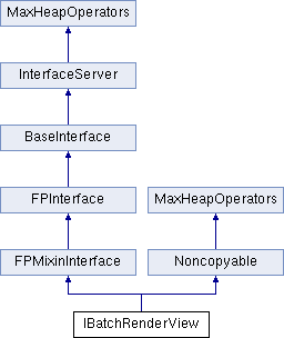

+ Inheritance diagram for IBatchRenderView:
