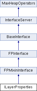

ILayerProperties Class Reference
ILayerProperties Class Referenceabstract
#include <ILayerProperties.h>
+ Inheritance diagram for ILayerProperties:
