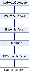

+ Inheritance diagram for INodeExposure:
