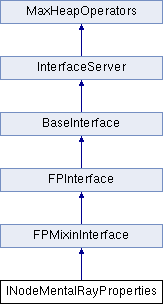

Extension to INode for accessing mental ray properties.
This interface class defines a set of methods for accessing mental ray properties on an INode. To get a pointer to this interface from an INode, call:
INodeMentalRayProperties* mr_properties = Get_INodeMentalRayProperties(node);
The properties exposed by this class to the SDK are also exposed to MaxScript through the function publishing system.
