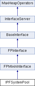

| virtual int | NumPFSystems ()=0 |
| | returns number of PFSystems in the current scene More...
| virtual INode * | GetPFSystem (int i)=0 |
| | Returns i-th PFSystem in the scene. More...
| virtual bool | HasPFSystem (INode *node)=0 |
| | Checks if the given PFSystem node is present in the scene. More...
| virtual bool | HasPFSystemByHandle (int handle)=0 |
| | Check if the scene has a PFSystem with the given node handle. More...
| virtual int | RegisterNotification (NOTIFYPROC proc, void *param)=0 |
| | Register notification with the PFSystem pool. More...
| virtual int | UnRegisterNotification (NOTIFYPROC proc, void *param)=0 |
| | Unregister notification with the PFSystem pool. More...
