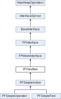

| BEGIN_FUNCTION_MAP | FN_0 (kNumPViewParamBlocks, TYPE_INT, NumPViewParamBlocks) |
| | FN_1 (kGetPViewParamBlock, TYPE_REFTARG, GetPViewParamBlock, TYPE_INDEX) |
| | FN_1 (kHasComments, TYPE_bool, HasComments, TYPE_INODE) |
| | FN_1 (kGetComments, TYPE_STRING, GetComments, TYPE_INODE) |
| | VFN_2 (kSetComments, SetComments, TYPE_INODE, TYPE_STRING) |
| | FN_2 (kGetWireExtension, TYPE_INT, GetWireExtension, TYPE_INODE, TYPE_INT) |
| | VFN_3 (kSetWireExtension, SetWireExtension, TYPE_INODE, TYPE_INT, TYPE_INT) |
| | IPViewItem () |
| virtual int | NumPViewParamBlocks () const =0 |
| virtual IParamBlock2 * | GetPViewParamBlock (int i) const =0 |
| PFExport int | NumPViewParamMaps () const |
| PFExport IParamMap2 * | GetPViewParamMap (int i) const |
| PFExport void | AddPViewParamMap (IParamMap2 *map) |
| PFExport void | RemovePViewParamMap (IParamMap2 *map) |
| virtual bool | HasCustomPViewIcons () |
| | Implement if you want your operator/test to be shown with a custom icon in ParticleView. More...
| virtual bool | HasTransparentPViewIcons () const |
| | Defines whether the custom icons in Particle View have alpha channels. More...
| virtual HBITMAP | GetActivePViewIcon () |
| virtual HBITMAP | GetInactivePViewIcon () |
| virtual HBITMAP | GetTruePViewIcon () |
| virtual HBITMAP | GetFalsePViewIcon () |
| virtual bool | ShowColorSwatch () const |
| | An operator may have a color swatch UI (color circle on the right side) if it can be used to display particles in viewport. More...
| PFExport int | GetNumInstances () const |
| | Used to track instanced actions. More...
| PFExport void | SetNumInstances (int num) |
| PFExport void | IncNumInstances () |
| PFExport bool | HasComments (INode *itemNode) const |
| | A PView item can have comments. More...
| PFExport const MCHAR * | GetComments (INode *itemNode) const |
| | See HasComments(). More...
| PFExport void | SetComments (INode *itemNode, const MCHAR *comments) |
| PFExport void | EditComments (INode *itemNode, HWND parentWnd, long x, long y) |
| PFExport LRESULT CALLBACK | commentsProc (HWND hwnd, UINT message, WPARAM wParam, LPARAM lParam) |
| | For internal use. More...
| virtual bool | HasDynamicName (MSTR &nameSuffix) |
| | For dynamic names support; if the action has a dynamic name then it supplies the name suffix. More...
| FPInterfaceDesc * | GetDesc () |
| | FPMixinInterface () |
| virtual LifetimeType | LifetimeControl () |
| virtual CoreExport bool | RegisterNotifyCallback (InterfaceNotifyCallback *incb) |
| virtual void | UnRegisterNotifyCallback (InterfaceNotifyCallback *incb) |
| CoreExport | ~FPMixinInterface () |
| virtual BaseInterface * | GetInterface (Interface_ID id) |
| virtual FPInterfaceDesc * | GetDescByID (Interface_ID id) |
| virtual Interface_ID | GetID () |
| virtual CoreExport FPStatus | Invoke (FunctionID fid, TimeValue t=0, FPParams *params=NULL) |
| virtual FPStatus | Invoke (FunctionID fid, FPParams *params) |
| virtual CoreExport FPStatus | Invoke (FunctionID fid, TimeValue t, FPValue &result, FPParams *params=NULL) |
| virtual FPStatus | Invoke (FunctionID fid, FPValue &result, FPParams *params=NULL) |
| virtual CoreExport FunctionID | FindFn (const MCHAR *name) |
| virtual CoreExport BOOL | IsEnabled (FunctionID actionID) |
| virtual CoreExport BOOL | IsChecked (FunctionID actionID) |
| virtual CoreExport BOOL | IsVisible (FunctionID actionID) |
| virtual CoreExport FunctionID | GetIsEnabled (FunctionID actionID) |
| virtual CoreExport FunctionID | GetIsChecked (FunctionID actionID) |
| virtual CoreExport FunctionID | GetIsVisible (FunctionID actionID) |
| virtual ActionTable * | GetActionTable () |
| virtual void | EnableActions (BOOL onOff) |
| virtual UtilExport | ~BaseInterface () |
| | Destructor. More...
| virtual BaseInterface * | AcquireInterface () |
| virtual void | ReleaseInterface () |
| virtual void | DeleteInterface () |
| virtual BaseInterface * | CloneInterface (void *remapDir=NULL) |
| virtual UtilExport | ~InterfaceServer () |
| | Destructor. More...
| static PFExport int | GetWireExtension (INode *node, int &wireHeight) |
| | To read/modify the length/height of the wire nub extended from an emitter, or an action list, or a test. More...
| static PFExport void | SetWireExtension (INode *node, int wireLen, int wireHight) |
| | Sets wire length. More...
| static UtilExport void * | operator new (size_t size) |
| | Standard new operator used to allocate objects If there is insufficient memory, an exception will be thrown. More...
| static UtilExport void * | operator new (size_t size, const std::nothrow_t &e) |
| | Standard new operator used to allocate objects if there is insufficient memory, NULL will be returned. More...
| static UtilExport void * | operator new (size_t size, const char *filename, int line) |
| | New operator used to allocate objects that takes the filename and line number where the new was called If there is insufficient memory, an exception will be thrown. More...
| static UtilExport void * | operator new (size_t size, int block_type, const char *filename, int line) |
| | New operator used to allocate objects that takes the type of memory, filename and line number where the new was called If there is insufficient memory, an exception will be thrown. More...
| static UtilExport void * | operator new (size_t size, const std::nothrow_t &e, const char *filename, int line) |
| | New operator used to allocate objects that takes the filename and line number where the new was called If there is insufficient memory, NULL will be returned. More...
| static UtilExport void * | operator new (size_t size, unsigned long flags) |
| | New operator used to allocate objects that takes extra flags to specify special operations If there is insufficient memory, an exception will be thrown. More...
| static UtilExport void * | operator new (size_t size, const std::nothrow_t &e, unsigned long flags) |
| | New operator used to allocate objects that takes extra flags to specify special operations If there is insufficient memory, NULL will be returned. More...
| static UtilExport void * | operator new[] (size_t size) |
| | New operator used to allocate arrays of objects If there is insufficient memory, an exception will be thrown. More...
| static UtilExport void * | operator new[] (size_t size, const std::nothrow_t &e) |
| | New operator used to allocate arrays of objects If there is insufficient memory, NULL will be returned. More...
| static UtilExport void * | operator new[] (size_t size, const char *filename, int line) |
| static UtilExport void * | operator new[] (size_t size, int block_type, const char *filename, int line) |
| | New operator used to allocate arrays of objects. More...
| static UtilExport void * | operator new[] (size_t size, const std::nothrow_t &e, const char *filename, int line) |
| static UtilExport void * | operator new[] (size_t size, unsigned long flags) |
| static UtilExport void * | operator new[] (size_t size, const std::nothrow_t &e, unsigned long flags) |
| static UtilExport void | operator delete (void *ptr) |
| | Standard delete operator used to deallocate an object If the pointer is invalid, an exception will be thrown. More...
| static UtilExport void | operator delete (void *ptr, const std::nothrow_t &e) |
| | Standard delete operator used to deallocate an object If the pointer is invalid, nothing will happen. More...
| static UtilExport void | operator delete (void *ptr, const char *filename, int line) |
| | Delete operator used to deallocate an object that takes the filename and line number where the delete was called If the pointer is invalid, an exception will be thrown. More...
| static UtilExport void | operator delete (void *ptr, int block_type, const char *filename, int line) |
| | Delete operator used to deallocate an object that takes the type of memory, filename and line number where the delete was called If the pointer is invalid, an exception will be thrown. More...
| static UtilExport void | operator delete (void *ptr, const std::nothrow_t &e, const char *filename, int line) |
| | Delete operator used to deallocate an object that takes the filename and line number where the delete was called If the pointer is invalid, nothing will happen. More...
| static UtilExport void | operator delete (void *ptr, unsigned long flags) |
| | Delete operator used to deallocate an object that takes extra flags to specify special operations If the pointer is invalid, an exception will be thrown. More...
| static UtilExport void | operator delete (void *ptr, const std::nothrow_t &e, unsigned long flags) |
| | Delete operator used to deallocate an object that takes extra flags to specify special operations If the pointer is invalid, nothing will happen. More...
| static UtilExport void | operator delete[] (void *ptr) |
| | Standard delete operator used to deallocate an array of objects If the pointer is invalid, an exception will be thrown. More...
| static UtilExport void | operator delete[] (void *ptr, const std::nothrow_t &e) |
| | Standard delete operator used to deallocate an array of objects If the pointer is invalid, nothing will happen. More...
| static UtilExport void | operator delete[] (void *ptr, const char *filename, int line) |
| | Delete operator used to deallocate an array of objects that takes the filename and line number where the delete was called If the pointer is invalid, an exception will be thrown. More...
| static UtilExport void | operator delete[] (void *ptr, int block_type, const char *filename, int line) |
| | Delete operator used to deallocate an array of objects that takes the type of memory, filename and line number where the delete was called If the pointer is invalid, an exception will be thrown. More...
| static UtilExport void | operator delete[] (void *ptr, const std::nothrow_t &e, const char *filename, int line) |
| | Delete operator used to deallocate an array of objects that takes the filename and line number where the delete was called If the pointer is invalid, nothing will happen. More...
| static UtilExport void | operator delete[] (void *ptr, unsigned long flags) |
| | Delete operator used to deallocate an array of objects that takes extra flags to specify special operations If the pointer is invalid, an exception will be thrown. More...
| static UtilExport void | operator delete[] (void *ptr, const std::nothrow_t &e, unsigned long flags) |
| static UtilExport void * | operator new (size_t size, void *placement_ptr) |
| | Placement new operator. More...
| static UtilExport void | operator delete (void *ptr, void *placement_ptr) |
| | Placement delete operator. More...
