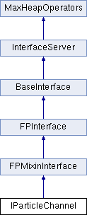

| PFExport | IParticleChannel () |
| PFExport | IParticleChannel (const Interface_ID &readID, const Interface_ID &writeID) |

| FPInterfaceDesc * | GetDesc () |
| | FPMixinInterface () |
| virtual LifetimeType | LifetimeControl () |
| virtual CoreExport bool | RegisterNotifyCallback (InterfaceNotifyCallback *incb) |
| virtual void | UnRegisterNotifyCallback (InterfaceNotifyCallback *incb) |
| CoreExport | ~FPMixinInterface () |
| virtual BaseInterface * | GetInterface (Interface_ID id) |
| virtual FPInterfaceDesc * | GetDescByID (Interface_ID id) |
| virtual Interface_ID | GetID () |
| virtual CoreExport FPStatus | Invoke (FunctionID fid, TimeValue t=0, FPParams *params=NULL) |
| virtual FPStatus | Invoke (FunctionID fid, FPParams *params) |
| virtual CoreExport FPStatus | Invoke (FunctionID fid, TimeValue t, FPValue &result, FPParams *params=NULL) |
| virtual FPStatus | Invoke (FunctionID fid, FPValue &result, FPParams *params=NULL) |
| virtual CoreExport FunctionID | FindFn (const MCHAR *name) |
| virtual CoreExport BOOL | IsEnabled (FunctionID actionID) |
| virtual CoreExport BOOL | IsChecked (FunctionID actionID) |
| virtual CoreExport BOOL | IsVisible (FunctionID actionID) |
| virtual CoreExport FunctionID | GetIsEnabled (FunctionID actionID) |
| virtual CoreExport FunctionID | GetIsChecked (FunctionID actionID) |
| virtual CoreExport FunctionID | GetIsVisible (FunctionID actionID) |
| virtual ActionTable * | GetActionTable () |
| virtual void | EnableActions (BOOL onOff) |
| virtual UtilExport | ~BaseInterface () |
| | Destructor. More...
| virtual BaseInterface * | AcquireInterface () |
| virtual void | ReleaseInterface () |
| virtual void | DeleteInterface () |
| virtual BaseInterface * | CloneInterface (void *remapDir=NULL) |
