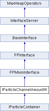

IParticleChannelAmountW Class Reference
IParticleChannelAmountW Class Referenceabstract
#include <IParticleChannelAmount.h>
+ Inheritance diagram for IParticleChannelAmountW:
