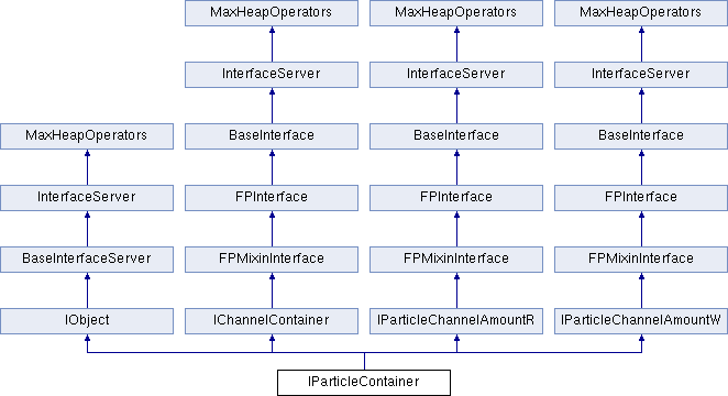

#include <IParticleContainer.h>
Inheritance diagram for IParticleContainer:Additional Inherited Members | |
