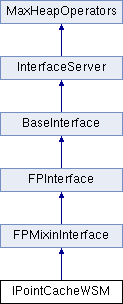

+ Inheritance diagram for IPointCacheWSM:
