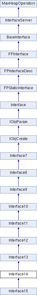

This reference page is linked to from the following overview topics: #include <maxapi.h>
Extends Interface13 Client code should retrieve this interface using GetCOREInterface14.
Inheritance diagram for Interface14:Public Member Functions | |
