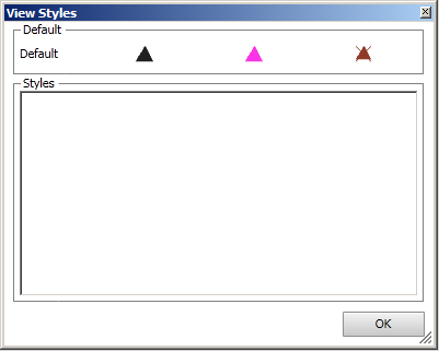

  3. To display only the feature classes in the design, click Design Mode.
  4. Right-click the feature class of interest and click View Style.
    The style for the feature class is displayed.
    You can view the style but cannot edit it. To edit the style, see To Configure the Industry Model.
