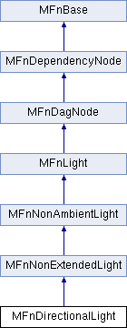

Inheritance diagram for MFnDirectionalLight:Public Member Functions | |
