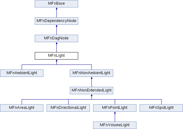

+ Inheritance diagram for MFnLight:

MFn::Type type ( ) const
virtual
Function set type.
Return the class type : MFn::kLight.
Reimplemented from MFnDagNode.
Reimplemented in MFnPointLight, MFnSpotLight, MFnVolumeLight, MFnNonAmbientLight, MFnNonExtendedLight, MFnAmbientLight, MFnAreaLight, and MFnDirectionalLight.
const char * className ( ) const
protectedvirtual
Class name.
Return the class name : "MFnLight".
