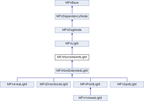

Inheritance diagram for MFnNonAmbientLight:Public Member Functions | |

| Determines the dormant color used by this node. More... | |
| MColor | activeColor (MStatus *ReturnStatus=NULL) const |
| Determines the active color used by this node. More... | |
| bool | drawOverrideEnabled (MStatus *ReturnStatus=NULL) const |
| Determines whether or not draw override is turned on for this node. More... | |
| bool | drawOverrideIsReference (MStatus *ReturnStatus=NULL) const |
| Determines whether or not Display Type of the draw override is Reference for this node. More... | |
| bool | drawOverrideIsTemplate (MStatus *ReturnStatus=NULL) const |
| Determines whether or not Display Type of the draw override is Template for this node. More... | |
| bool | drawOverrideColor (MColor &color, MStatus *ReturnStatus=NULL) const |
| Determines the draw override color used by this node. More... | |
| MStatus | getConnectedSetsAndMembers (unsigned int instanceNumber, MObjectArray &sets, MObjectArray &comps, bool renderableSetsOnly) const |
| Returns all the sets connected to the specified instance of this DAG object. More... | |
| MBoundingBox | boundingBox (MStatus *ReturnStatus=NULL) const |
| Returns the bounding box for the dag node in object space. More... | |
| MDagPath | dagPath (MStatus *ReturnStatus=NULL) const |
| Returns the DagPath to which the Function Set is attached. More... | |
| virtual MStatus | setObject (const MDagPath &path) |
| Attaches Function Set to the DAG Node that has the given DAG Path. More... | |
| virtual MStatus | setObject (MObject &object) |
| Attaches Function Set to given DAG Node. More... | |
| MObject | model (MStatus *ReturnStatus=NULL) const |
| This method is obsolete. More... | |
| MFnDagNode (const MObject &object, MStatus *ret=NULL) | |
| No script support. More... | |
| virtual MStatus | setObject (const MObject &object) |
Public Member Functions inherited from MFnDependencyNode | |
| virtual | ~MFnDependencyNode () |
| Destructor. | |
| MFnDependencyNode () | |
| Default constructor. | |
| MFnDependencyNode (MObject &object, MStatus *ReturnStatus=NULL) | |
| Constructor. More... | |
| MObject | create (const MTypeId &typeId, MStatus *ReturnStatus=NULL) |
| Creates a new dependency node with the given type tag. More... | |
| MObject | create (const MTypeId &typeId, const MString &name, MStatus *ReturnStatus=NULL) |
| MObject | create (const MString &type, MStatus *ReturnStatus=NULL) |
| Creates a new dependency node with the given type. More... | |
| MObject | create (const MString &type, const MString &name, MStatus *ReturnStatus=NULL) |
| MTypeId | typeId (MStatus *ReturnStatus=NULL) const |
| Returns the type id of this node. More... | |
| MString | typeName (MStatus *ReturnStatus=NULL) const |
| Returns the type name of this node. More... | |
| MString | name (MStatus *ReturnStatus=NULL) const |
| Returns the name of this node. More... | |
| MString | pluginName (MStatus *ReturnStatus=NULL) const |
| Returns the name of the plug-in this MFnDependendencyNode was defined in. More... | |
| MString | setName (const MString &name, bool createNamespace=false, MStatus *ReturnStatus=NULL) |
| Sets the name of this node. More... | |
| MStatus | getConnections (MPlugArray &array) const |
| Get all of the current connections to this node as an array of plugs. More... | |
| unsigned int | attributeCount (MStatus *ReturnStatus=NULL) const |
| Returns the number of attributes that this node has. More... | |
| MObject | attribute (unsigned int index, MStatus *ReturnStatus=NULL) const |
| Finds the attribute of this node at the given index. More... | |
| MObject | reorderedAttribute (unsigned int index, MStatus *ReturnStatus=NULL) const |
| Some nodes, such as the various animCurve nodes, require that their attributes be set in a specific order for proper operation. More... | |
| MObject | attribute (const MString &attrName, MStatus *ReturnStatus=NULL) const |
| Finds the attribute of this node that has the given name. More... | |
| MAttrClass | attributeClass (const MObject &attr, MStatus *ReturnStatus=NULL) const |
| Returns the class (normal, dynamic, extension) of the specified attribute. More... | |
| MStatus | getAffectedAttributes (const MObject &attr, MObjectArray &affectedAttributes) const |
| Returns an array of attributes that are affected by the attribute passed in. More... | |
| MStatus | getAffectedByAttributes (const MObject &attr, MObjectArray &affectedByAttributes) const |
| Returns an array of attributes that affect the attribute passed in, attr. More... | |
| MPlug | findPlug (const MObject &attr, bool wantNetworkedPlug, MStatus *ReturnStatus=NULL) const |
| Attempt to find a plug for the given attribute. More... | |
| MPlug | findPlug (const MString &attrName, bool wantNetworkedPlug, MStatus *ReturnStatus=NULL) const |
| MPlug | findPlug (const MObject &attr, MStatus *ReturnStatus=NULL) const |
| MPlug | findPlug (const MString &attrName, MStatus *ReturnStatus=NULL) const |
| MStatus | addAttribute (const MObject &attr) |
| Add a new dynamic attibute to this node. More... | |
| MStatus | removeAttribute (const MObject &attr) |
| Remove a dynamic attribute from a node. More... | |
| MPxNode * | userNode (MStatus *ReturnStatus=NULL) const |
| If the function set's node is a plug-in node, then this method will extract the MPxNode pointer from it. More... | |
| bool | isFromReferencedFile (MStatus *ReturnStatus=NULL) const |
| Indicates whether or not this node came from a referenced file. More... | |
| bool | isShared (MStatus *ReturnStatus=NULL) const |
| Indicates whether or not this node is shared. More... | |
| bool | isTrackingEdits (MStatus *ReturnStatus=NULL) const |
| Returns whether or not edits on the given node are being tracked by the generalized edit system. More... | |
| bool | hasUniqueName (MStatus *ReturnStatus=NULL) const |
| Indicates whether or not this node's name is unique within the scene. More... | |
| MString | parentNamespace (MStatus *ReturnStatus=NULL) const |
| Returns the name of the namespace in which this node resides. More... | |
| bool | isLocked (MStatus *ReturnStatus=NULL) const |
| Indicates whether or not this node is locked. More... | |
| MStatus | setLocked (bool locked) |
| Locks or unlocks this node. More... | |
| bool | isNewAttribute (const MObject &attr, MStatus *ReturnStatus=NULL) const |
| Indicates whether or not the specified attribute was added to this node within the current scene. More... | |
| MStatus | setFlag (unsigned int flag, bool state) |
| Sets the state of the specified flag for the node. More... | |
| bool | isFlagSet (unsigned int flag, MStatus *ReturnStatus=NULL) const |
| Retrieves the current state of the specified flag for a node. More... | |
| bool | isDefaultNode (MStatus *ReturnStatus=NULL) const |
| Returns true if the node is a default node. More... | |
| MStatus | setDoNotWrite (bool flag) |
| Use this method to mark the "do not write" state of this node. More... | |
| bool | canBeWritten (MStatus *ReturnStatus=NULL) const |
| Returns the do not write state of the node. More... | |
| bool | hasAttribute (const MString &name, MStatus *ReturnStatus=NULL) const |
| Returns true if the node already has an attribute with the given name. More... | |
| MObject | getAliasAttr (bool force, MStatus *ReturnStatus=NULL) |
| Returns the node's alias attribute, which is a special attribute used to store information about the node's attribute aliases. More... | |
| bool | setAlias (const MString &alias, const MString &name, const MPlug &plug, bool add=true, MStatus *ReturnStatus=NULL) |
| Sets or removes an alias (i.e. More... | |
| bool | findAlias (const MString &alias, MObject &attrObj, MStatus *ReturnStatus=NULL) const |
| Retrieves the attribute with the given alias. More... | |
| bool | getAliasList (MStringArray &strArray, MStatus *ReturnStatus=NULL) |
| Returns a list of all attribute aliases for this node. More... | |
| MString | plugsAlias (const MPlug &plug, MStatus *ReturnStatus=NULL) |
| Returns the alias for the plug's attribute or the empty string if that attribute has no alias. More... | |
| MStatus | setIcon (const MString &filename) |
| Associates a custom icon with the node for display in the Maya UI. More... | |
| MString | icon (MStatus *ReturnStatus=NULL) const |
| Returns the custom icon filename associated with the node. More... | |
| MString | setName (const MString &name, MStatus *ReturnStatus) |
| OBSOLETE FUNCTION, NO SCRIPT SUPPORT. More... | |
| MFnDependencyNode (const MObject &object, MStatus *ReturnStatus=NULL) | |
| bool | getPlugsAlias (const MPlug &plug, MString &aliasName, MStatus *ReturnStatus=NULL) |
| virtual const adsk::Data::Associations * | metadata (MStatus *ReturnStatus=NULL) const |
| This method is not available in Python. More... | |
| virtual MStatus | setMetadata (const adsk::Data::Associations &) |
| virtual MStatus | deleteMetadata () |
| virtual MStatus | validateMetadata (MString &errors) const |
| MStatus | dgTimerOn () |
| Indicates that this node should collect DG timing data whenever DG timing is enabled. More... | |
| MStatus | dgTimerOff () |
| Indicates that this node should no longer collect DG timing data when DG timing is enabled. More... | |
| MdgTimerState | dgTimerQueryState (MStatus *ReturnStatus=NULL) |
| The function returns the current on/off state of the node's timer. More... | |
| MStatus | dgTimerReset () |
| The function resets the dependency graph timers and counters for this node to zero. More... | |
| double | dgTimer (const MdgTimerMetric timerMetric, const MdgTimerType timerType, MStatus *ReturnStatus=NULL) const |
| The function returns the specified timer value for the current node. More... | |
| MStatus | dgCallbacks (const MdgTimerType type, MStringArray &callbackName, MDoubleArray &value) |
| Node callbacks that occur when timing is enabled get logged with the node and can be queried via this method. More... | |
| MStatus | dgCallbackIds (const MdgTimerType type, const MString &callbackName, MCallbackIdArray &callbackId, MDoubleArray &value) |
| This method provides a further breakdown of the per-callback time returned via dgCallbacks() by returning the data on a per-callbackId basis. More... | |
| MStatus | addAttribute (const MObject &attr, MAttrClass type) |
| MStatus | removeAttribute (const MObject &attr, MAttrClass type) |
Public Member Functions inherited from MFnBase | |
| virtual | ~MFnBase () |
| Class Destructor. More... | |
| bool | hasObj (MFn::Type) const |
| Determines whether or not the Function Set is compatible with the specified Maya Object type within the API RTTI system. More... | |
| bool | hasObj (const MObject &) const |
| Determines whether or not the Function Set is compatible with the specified Maya Object within the API RTTI system. More... | |
| MObject | object (MStatus *ReturnStatus=NULL) const |
| Returns the MObject that is attached to the Function Set. More... | |
Protected Member Functions | |
| virtual const char * | className () const |
| Class name. More... | |
Additional Inherited Members | |
Public Types inherited from MFnDagNode | |
| enum | { kNextPos = 0xff } |
| Anonymous enum to store constant values. More... | |
Public Types inherited from MFnDependencyNode | |
| enum | MAttrClass { kLocalDynamicAttr = 1, kNormalAttr, kExtensionAttr, kInvalidAttr } |
| Specifies the scope of the attribute. More... | |
| enum | MdgTimerState { kTimerOff, kTimerOn, kTimerUninitialized, kTimerInvalidState } |
| Possible states for the node's timer. More... | |
| enum | MdgTimerMetric { kTimerMetric_callback, kTimerMetric_compute, kTimerMetric_dirty, kTimerMetric_draw, kTimerMetric_fetch, kTimerMetric_callbackViaAPI, kTimerMetric_callbackNotViaAPI, kTimerMetric_computeDuringCallback, kTimerMetric_computeNotDuringCallback, kTimerMetrics } |
| The different timer metrics which can be queried. More... | |
| enum | MdgTimerType { kTimerType_self, kTimerType_inclusive, kTimerType_count, kTimerTypes } |
| The types of timers which can be queried. More... | |
Static Public Member Functions inherited from MFnDependencyNode | |
| static MString | classification (const MString &nodeTypeName) |
| Retrieves the classification string for a node type. More... | |
| static unsigned int | allocateFlag (const MString pluginName, MStatus *ReturnStatus=NULL) |
| Allocates a node flag for sole use by the caller. More... | |
| static MStatus | deallocateFlag (const MString pluginName, unsigned int flag) |
| Deallocates a node flag which was previously allocated by a call to allocateFlag. More... | |
| static MStatus | deallocateAllFlags (const MString pluginName) |
| Deallocates all of the node flags which are currently allocated to the specified plugin. More... | |
| static void | enableDGTiming (bool enable) |
| Globally enables or disables the DG node timing mechanism. More... | |
Static Public Member Functions inherited from MFnBase | |
| static const char * | className () |
| Returns the name of this class. More... | |
virtual |
Destructor.
The class destructor.
| MFnNonAmbientLight | ( | MObject & | object, |
| MStatus * | ReturnStatus = NULL |
Constructor.
Class constructor that initializes the function set to the given MObject.
| [in] | object | The MObject to attach the function set to |
| [out] | ReturnStatus | the return status |
| MFnNonAmbientLight | ( | const MDagPath & | object, |
Constructor.
Class constructor that initializes the function set to the given constant MDagPath object.
