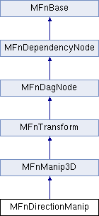

Inheritance diagram for MFnDirectionManip:Public Member Functions | |
