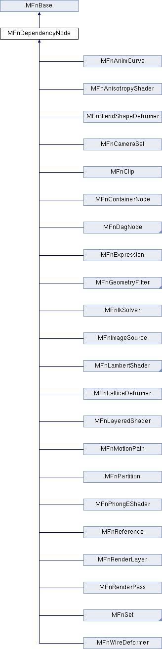

Inheritance diagram for MFnDependencyNode:Public Types | |

Reimplemented from MFnBase.
Reimplemented in MFnSubd, MFnAnimCurve, MFnMesh, MFnTransform, MFnNurbsSurface, MFnClip, MFnCharacter, MFnNurbsCurve, MFnParticleSystem, MFnAssembly, MFnBlendShapeDeformer, MFnIkJoint, MFnWeightGeometryFilter, MFnLatticeDeformer, MFnSkinCluster, MFnCameraSet, MFnLattice, MFnSet, MFnGeometryFilter, MFnDagNode, MFnMotionPath, MFnPartition, MFnFluid, MFnImageSource, MFnWireDeformer, MFnContainerNode, MFnRotateManip, MFnScaleManip, MFnLight, MFnRenderLayer, MFnToggleManip, MFnCircleSweepManip, MFnDirectionManip, MFnDiscManip, MFnRenderPass, MFnStateManip, MFnCurveSegmentManip, MFnField, MFnFreePointTriadManip, MFnHikEffector, MFnInstancer, MFnLayeredShader, MFnPhongEShader, MFnPointOnCurveManip, MFnPointOnSurfaceManip, MFnPointLight, MFnReflectShader, MFnSpotLight, MFnVolumeLight, MFnAnisotropyShader, MFnExpression, MFnIkHandle, MFnLambertShader, MFnPfxGeometry, MFnPhongShader, MFnDistanceManip, MFnIkEffector, MFnIkSolver, MFnDragField, MFnNewtonField, MFnNonAmbientLight, MFnNonExtendedLight, MFnRadialField, MFnVortexField, MFnAmbientLight, MFnAreaLight, MFnDirectionalLight, MFnGravityField, MFnTurbulenceField, MFnUniformField, MFnVolumeAxisField, MFnAirField, MFnBlinnShader, MFnCamera, MFnReference, and MFnManip3D.
