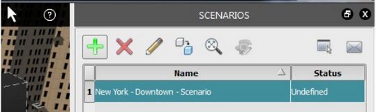

To view the status of a scenario generation
The Scenario Browser panel allows you to view the status of a scenario generation and publication to the cloud.
  1. Click to open the Scenario Browser.
    After syncing the model, a scenario will be in one of the following states:
Undefined The scenario has been created but not all required information is complete in the Scenario Editor. You must supply the Name of scenario and proposal and Set the area of interest.
Out of Sync Changing a scenario definition requires re-syncing the model. Sync again.
Generating The scenario is being generated in the cloud.
Published Scenario generation has completed successfully. The scenario is available for viewing.
Problem Regeneration with a new or changed scenario definition doesn't complete. See Troubleshooting scenario publication.
