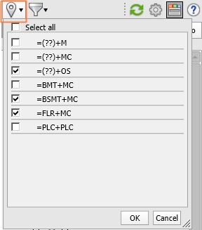

  1. Click Project tabProject Tools panelManager. Find
  2. In the Project Manager, click the Location View tab.
  3. In the Location View, click Filter by Installation and Location .
  4. Clear Select All, and select the values you want to show in your component tree view.
    Note: If the AutoCAD Electrical project is not linked to an Inventor project, the Location View buttons do not match the image shown.
  5. Click OK.
