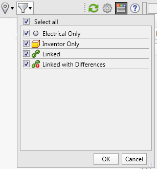

  1. Click Project tabProject Tools panelManager. Find
  2. In the Project Manager, click the Location View tab.
  3. In the Location View, click Filter by Component Status .
    Note: The Filter by Component Status button is available when you have a linked AutoCAD Electrical and Inventor project.
  4. Clear Select All, and select the values you want to show in your component tree view.
  5. Click OK.
