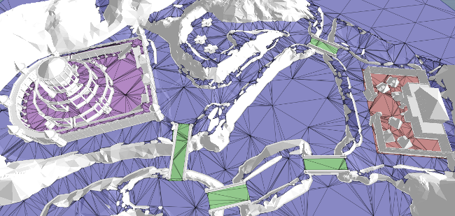

The following image shows a visual representation of a NavMesh. Note that the colored triangles of the NavMesh form a surface that fills the walkable areas of the terrain. Note also that the boundaries of the NavMesh are a short distance away from the walls and static obstacles. This distance is roughly equal to half the width of the character using the NavMesh. Preventing the center of the character (where its position is assumed to be) from moving any closer than this to the static obstacles avoids the possibility of collision with the static obstacles.

Note that the triangles of the NavMesh in the image above are colored differently in different areas. These colors represent different user-defined data values, known as NavTags, that have been assigned to the triangles to represent different types of terrain. You can take advantage of these tags when setting up pathfinding for your characters, to specify the kinds of terrain that your characters can and cannot traverse, or you can associate them to smart objects that take control of characters' path following within those areas. See Tagging with Custom Data.

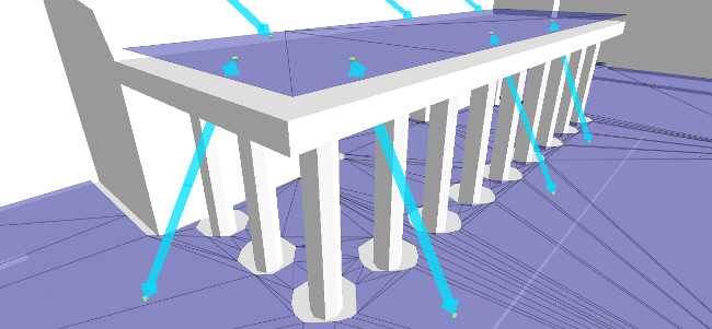

For instance, in the following image, the arrows represent NavGraph edges that connect points on the ground to points on the roof. These can be associated with a smart object that manages path following for any characters that plan a path along one of the edges, by playing a jump animation or computing a custom trajectory.
NavGraphs are an optional enhancement to the NavMesh, which you create and add to your NavData when you need them for a special movement type or smart object in your game. The NavData generation system never creates NavGraphs automatically on its own. You create them yourself, either during the data generation process (typically in a post-processing phase that you run after generating the NavMesh for a sector), or dynamically at runtime. See also Creating NavGraphs.
