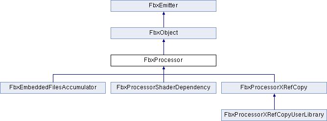

| virtual FbxClassId  | GetClassId () const  |
| bool  | ProcessCollection (FbxCollection *pCollection=0) |
|   | Process the specified collection.  More...
| bool  | ProcessObject (FbxObject *pCollection=0) |
|   | Process the specified object.  More...
| virtual void  | Compact () |
|   | Compact the memory used by this object.  More...
| template<class T >  |
| bool  | Is () const  |
|   | Templated test if this class is a hierarchical children of the specified class type.  More...
| FbxManager *  | GetFbxManager () const  |
|   | Retrieve the FbxManager this object belongs to.  More...
| FbxDocument *  | GetDocument () const  |
|   | Returns a const pointer to the document that contains this object.  More...
| FbxDocument *  | GetRootDocument () const  |
|   | Returns a const pointer to the root document that contains this object.  More...
| FbxScene *  | GetScene () const  |
|   | Returns a const pointer to the scene that contains this object.  More...
| void  | Destroy (bool pRecursive=false) |
|   | Unregister and delete this object from memory.  More...
| void  | ResetProperties () |
|   | Reset all the properties of this object to their default values.  More...
| virtual bool  | GetSelected () |
|   | Returns if this object is currently in a selected state.  More...
| virtual void  | SetSelected (bool pSelected) |
|   | Sets whether this object is currently selected.  More...
| void  | SetUserDataPtr (const FbxUInt64 &pUserID, void *pUserData) |
|   | Sets the data pointer for an user data record whose ID is pUserID.  More...
| void *  | GetUserDataPtr (const FbxUInt64 &pUserID) const  |
|   | Returns the data pointer of an user data record whose ID is pUserID.  More...
| void  | SetUserDataPtr (void *pUserData) |
|   | Sets the data pointer for the user data record whose ID is the object ID.  More...
| void *  | GetUserDataPtr () const  |
|   | Returns the data pointer of the user data record whose ID is the object ID.  More...
| bool  | ConnectSrcObject (FbxObject *pObject, FbxConnection::EType pType=FbxConnection::eNone) |
|   | Connects this object to a source object.  More...
| bool  | IsConnectedSrcObject (const FbxObject *pObject) const  |
|   | Judges whether this object connects with the source object.  More...
| bool  | DisconnectSrcObject (FbxObject *pObject) |
|   | Disconnects this object from a source object.  More...
| bool  | DisconnectAllSrcObject () |
|   | Disconnects this object from all source objects.  More...
| bool  | DisconnectAllSrcObject (const FbxCriteria &pCriteria) |
|   | Disconnects this object from all source objects that satisfy a given criteria.  More...
| int  | GetSrcObjectCount () const  |
|   | Returns the number of source objects with which this object connects.  More...
| int  | GetSrcObjectCount (const FbxCriteria &pCriteria) const  |
|   | Returns the number of source objects that satisfy the given criteria with which this object connects.  More...
| FbxObject *  | GetSrcObject (int pIndex=0) const  |
|   | Returns the source object with which this object connects at the specified index.  More...
| FbxObject *  | GetSrcObject (const FbxCriteria &pCriteria, int pIndex=0) const  |
|   | Returns the source object that satisfies the criteria at the specified index with which this object connects.  More...
| FbxObject *  | FindSrcObject (const char *pName, int pStartIndex=0) const  |
|   | Searches the source object with the specified name, starting at the specified index.  More...
| FbxObject *  | FindSrcObject (const FbxCriteria &pCriteria, const char *pName, int pStartIndex=0) const  |
|   | Searches the source object with the specified name which satisfies the given criteria, starting at the specified index.  More...
|   | Disconnects this object from all source objects of the specified class type.  More...
|   | Disconnects this object from all source objects that are of the specified class type and that satisfy the given criteria.  More...
|   | Returns the number of source objects of a specific class type with which this object connects.  More...
|   | Returns the number of source objects with which this object connects that are the specified class type and that satisfy the given criteria.  More...
| T *  | GetSrcObject (int pIndex=0) const  |
|   | Returns the source object of the specified class type at the specified index.  More...
| T *  | GetSrcObject (const FbxCriteria &pCriteria, int pIndex=0) const  |
|   | Returns the source object that is the specified class type and that satisfies the given criteria at the specified index.  More...
| T *  | FindSrcObject (const char *pName, int pStartIndex=0) const  |
|   | Searches the source object with the specified name that is the specified class type, starting at the specified index.  More...
| T *  | FindSrcObject (const FbxCriteria &pCriteria, const char *pName, int pStartIndex=0) const  |
|   | Searches the source object with the specified name that is the specified class type and that satisfies the given criteria, starting at the specified index.  More...
| bool  | ConnectDstObject (FbxObject *pObject, FbxConnection::EType pType=FbxConnection::eNone) |
|   | Connects this object to one destination object.  More...
| bool  | IsConnectedDstObject (const FbxObject *pObject) const  |
|   | Judges whether this object connects with the destination object.  More...
| bool  | DisconnectDstObject (FbxObject *pObject) |
|   | Disconnects this object from the destination object.  More...
| bool  | DisconnectAllDstObject () |
|   | Disconnects this object from all destination objects.  More...
| bool  | DisconnectAllDstObject (const FbxCriteria &pCriteria) |
|   | Disconnects this object from all destination objects that satisfy given criteria.  More...
| int  | GetDstObjectCount () const  |
|   | Returns the number of destination objects with which this object connects.  More...
| int  | GetDstObjectCount (const FbxCriteria &pCriteria) const  |
|   | Returns the number of destination objects with which this object connects that satisfy the given criteria.  More...
| FbxObject *  | GetDstObject (int pIndex=0) const  |
|   | Returns the destination object at the specified index with which this object connects.  More...
| FbxObject *  | GetDstObject (const FbxCriteria &pCriteria, int pIndex=0) const  |
|   | Returns the destination object with which this object connects that satisfies the given criteria at the specified index.  More...
| FbxObject *  | FindDstObject (const char *pName, int pStartIndex=0) const  |
|   | Searches the destination object with the specified name, starting at the specified index.  More...
| FbxObject *  | FindDstObject (const FbxCriteria &pCriteria, const char *pName, int pStartIndex=0) const  |
|   | Searches the destination object with the specified name which satisfies the given criteria, starting at the specified index.  More...
|   | Disconnects this object from all destination objects of the specified class type.  More...
|   | Disconnects this object from all destination objects that are the specified class type and that satisfy the given criteria.  More...
|   | Returns the number of destination objects of the specified class type with which this object connects.  More...
|   | Returns the number of destination objects with which this object connects that are the specified class type and that satisfy the given criteria.  More...
| T *  | GetDstObject (int pIndex=0) const  |
|   | Returns the destination object with which this object connects that is the specified class type at the specified index.  More...
| T *  | GetDstObject (const FbxCriteria &pCriteria, int pIndex=0) const  |
|   | Returns the destination object with which this object connects that is the specified class type and that satisfies the given criteria at the specified index.  More...
| T *  | FindDstObject (const char *pName, int pStartIndex=0) const  |
|   | Searches the destination object with the specified name which is of the specified class type, starting at the specified index.  More...
| T *  | FindDstObject (const FbxCriteria &pCriteria, const char *pName, int pStartIndex=0) const  |
|   | Searches the destination object with the specified name that is the specified class type and that satisfies the given criteria, starting at the specified index.  More...
| FbxProperty  | GetFirstProperty () const  |
|   | Returns the first property of this object.  More...
| FbxProperty  | GetNextProperty (const FbxProperty &pProperty) const  |
|   | Returns the next property of this object that follows the specified property.  More...
| FbxProperty  | FindProperty (const char *pName, bool pCaseSensitive=true) const  |
|   | Searches a property by name.  More...
| FbxProperty  | FindProperty (const char *pName, const FbxDataType &pDataType, bool pCaseSensitive=true) const  |
|   | Searches a property by name and data type.  More...
| FbxProperty  | FindPropertyHierarchical (const char *pName, bool pCaseSensitive=true) const  |
|   | Searches a property by full name.  More...
| FbxProperty  | FindPropertyHierarchical (const char *pName, const FbxDataType &pDataType, bool pCaseSensitive=true) const  |
|   | Searches a property by full name and data type.  More...
| FbxProperty  | GetClassRootProperty () |
|   | Returns the class root property.  More...
| bool  | ConnectSrcProperty (const FbxProperty &pProperty) |
|   | Connects this object to a source property.  More...
| bool  | IsConnectedSrcProperty (const FbxProperty &pProperty) |
|   | Determines whether this object connects with the specified source property.  More...
| bool  | DisconnectSrcProperty (const FbxProperty &pProperty) |
|   | Disconnects this object from the specified source property.  More...
| int  | GetSrcPropertyCount () const  |
|   | Returns the number of source properties with which this object connects.  More...
| FbxProperty  | GetSrcProperty (int pIndex=0) const  |
|   | Returns the source property at the specified index with which this object connects.  More...
| FbxProperty  | FindSrcProperty (const char *pName, int pStartIndex=0) const  |
|   | Searches a source property with which this object connects that has a specific name, starting at the specified index.  More...
| bool  | ConnectDstProperty (const FbxProperty &pProperty) |
|   | Connects this object to a destination property.  More...
| bool  | IsConnectedDstProperty (const FbxProperty &pProperty) |
|   | Determines if this object connects with the specified destination property.  More...
| bool  | DisconnectDstProperty (const FbxProperty &pProperty) |
|   | Disconnects this object from the specified destination property.  More...
| int  | GetDstPropertyCount () const  |
|   | Returns the number of destination properties with which this object connects.  More...
| FbxProperty  | GetDstProperty (int pIndex=0) const  |
|   | Returns the destination property at the specified index with which this object connects.  More...
