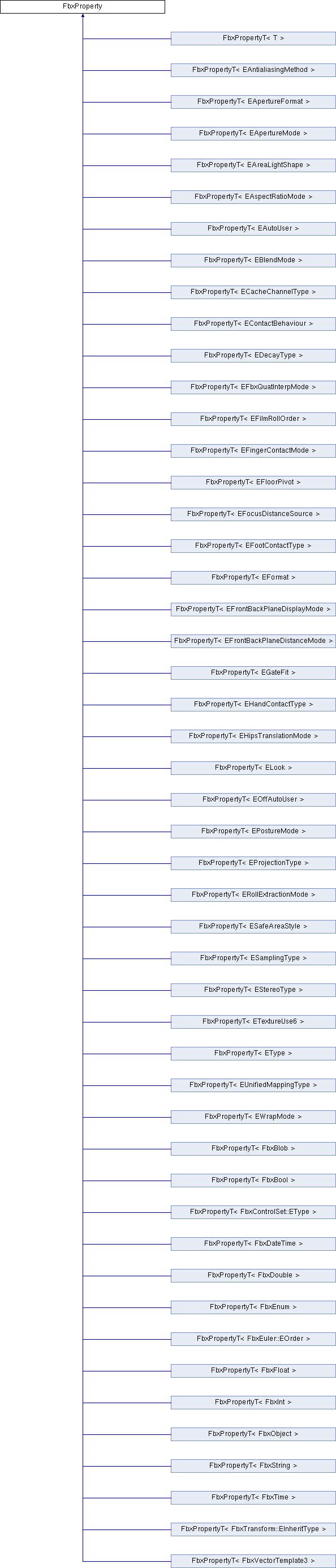

 Inheritance diagram for FbxProperty:Classes | |
