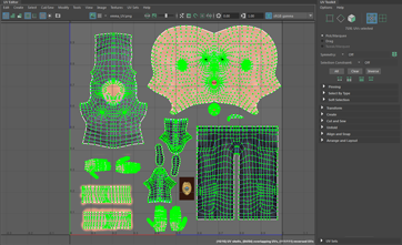

UV Editor new look and feel
The UV Editor interface has been completely overhauled for a more modern workflow. This includes a new UV Toolkit with better tools and functionality. For more information, see UV Editor Overview.
