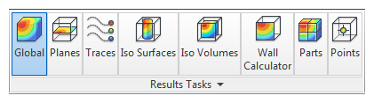

Results > Result Tasks
In this step, you learn how the flow and heat move within your model. Autodesk® CFD has some great tools for visualizing and extracting results.

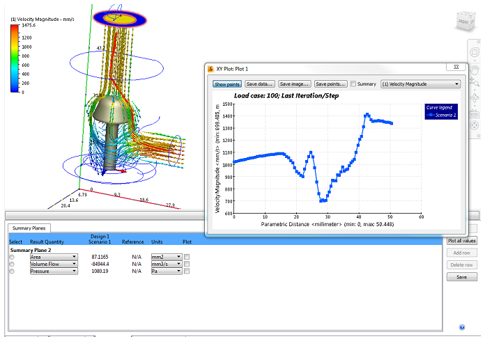

Flow control simulations usually show how the fluid flows through the device as well as either the pressure drop or the flow rate.
To practice with a flow control model, click here.

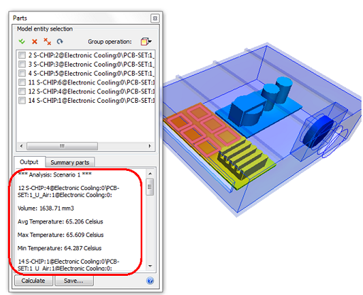

Electronic cooling simulations typically show component temperatures and how cooling air flows through the enclosure.
To practice with an electronics cooling model, click here.
