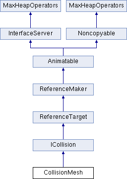

+ Inheritance diagram for CollisionMesh:
