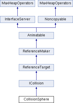

+ Inheritance diagram for CollisionSphere:
