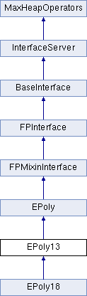

Inheritance diagram for EPoly13:Protected Types | |
