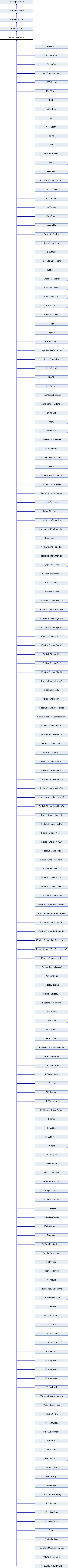

+ Inheritance diagram for FPMixinInterface:
