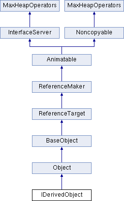

| virtual void | AddModifier (Modifier *mod, ModContext *mc=NULL, int before=0)=0 |
| virtual void | DeleteModifier (int index=0)=0 |
| virtual int | NumModifiers ()=0 |
| virtual Object * | GetObjRef ()=0 |
| virtual RefResult | ReferenceObject (Object *pob)=0 |
| virtual Modifier * | GetModifier (int index)=0 |
| virtual void | SetModifier (int index, Modifier *mod)=0 |
| virtual ModContext * | GetModContext (int index)=0 |
| virtual ObjectState | Eval (TimeValue t, int modIndex=0)=0 |
| CoreExport void | NotifyTarget (int msg, RefMakerHandle rm) |
| virtual CoreExport void * | GetInterface (ULONG id) |

| CoreExport | Object () |
| CoreExport | ~Object () |
