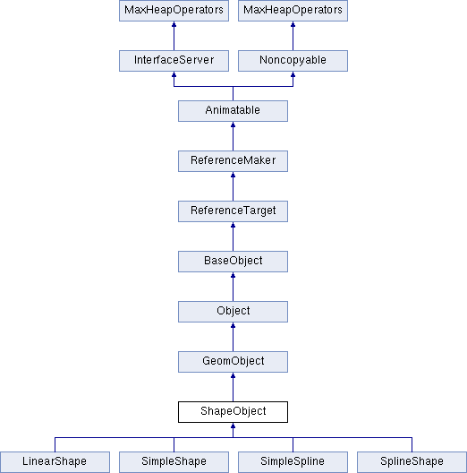

Class Description
ShapeObjects are open or closed hierarchical shapes made up of one or more pieces.
This base class defines a set of methods that plug-in shapes must implement. Note: Many plug-in shapes may be derived from Class SimpleSpline rather than this class and have fewer methods to implement. See that class for more details. Any classes subclassing off of ShapeObject should be sure to call the ShapeObject constructor in their constructor, in order to properly initialize the fields contained in the ShapeObject. This is the thickness field, which specifies the thickness of the mesh generated from the shape at rendering time. For example:
Also, the ShapeObject contains Load and Save methods, which handle the storage of the data contained within the ShapeObject. In order to properly store this information, classes which subclass off of ShapeObject need to call the ShapeObject Load and Save methods before storing their information. For example:
if(res != IO_OK)
return res;
if(res != IO_OK)
return res;
The number of ShapeObject references/subanims are defined as SHAPE_OBJ_NUM_REFS and SHAPE_OBJ_NUM_SUBS in /include/object.h and are set to the number of references and subanims in the ShapeObject class, you can use them to make your code more bullet-proof should the number of references change in the future. See maxsdk/include/splshape.h for an example of how they can be used.
See also
Class GeomObject, Class PolyShape
+ Inheritance diagram for ShapeObject:
