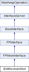

+ Inheritance diagram for IEditNormalsMod:
