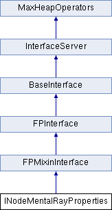

+ Inheritance diagram for INodeMentalRayProperties:
