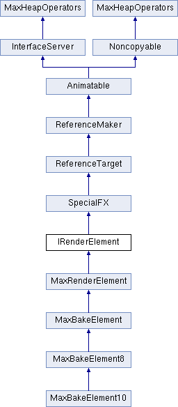

+ Inheritance diagram for IRenderElement:
