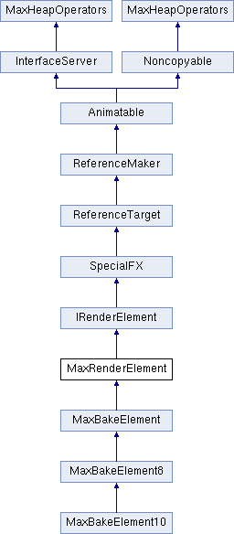

+ Inheritance diagram for MaxRenderElement:
