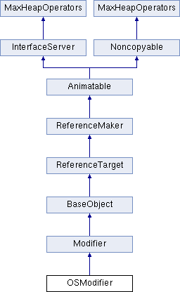

Inheritance diagram for OSModifier:Public Member Functions | |
