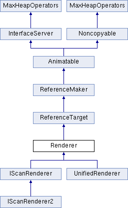

+ Inheritance diagram for Renderer:

SClass_ID SuperClassID ( )
inlinevirtual
Returns the super class ID RENDERER_CLASS_ID.
Reimplemented from ReferenceTarget.
Reimplemented in UnifiedRenderer, and UnifiedRenderer.
64 {return RENDERER_CLASS_ID;}
